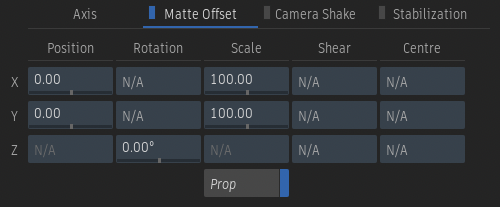

Matte Offset Settings
Position X field
Displays the X-axis offset applied to the matte. Editable.
Position Y field
Displays the Y-axis offset applied to the matte. Editable.
Rotation Z field
Displays the degree of rotation along the Z axis. Editable.
Scale X field
Displays the X-axis scaling offset applied to the matte. Editable.
Scale Y field
Displays the Y-axis scaling offset applied to the matte. Editable.

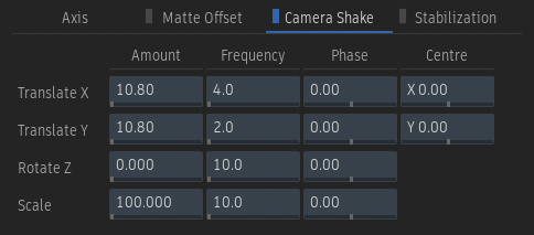

Camera Shake Settings
Camera Shake button
Enable to simulate camera shake in the image.
Translate X Amount field
Displays the amount of horizontal movement applied to the clip. Editable.
Translate Y Amount field
Displays the amount of vertical movement applied to the clip. Editable.
Rotation Z Amount field
Displays the degree of rotation on the Z axis. Available when Transform Type is set to Perspective. Editable.
Scale Amount field
Displays the amount of scaling applied to the clip. Editable.
Translate X Frequency field
Displays the frequency of horizontal movement applied to the clip. Editable.
Translate Y Frequency field
Displays the frequency of vertical movement applied to the clip. Editable.
Scale Frequency field
Displays the frequency of scaling applied to the clip. Editable.
Rotation Z Frequency field
Displays the frequency of rotation on the Z axis. Available when Transform Type is set to Perspective. Editable.
Translate X Phase field
Displays the phase of horizontal movement applied to the clip. Editable.
Translate Y Phase field
Displays the phase of vertical movement applied to the clip. Editable.
Rotation Z Phase field
Displays the phase of rotation on the Z axis. Editable.
Scale Phase field
Displays the phase of scaling applied to the clip. Editable.
X Centre field
Displays the centre point value of the clip along the horizontal axis. Available when Transform Type is set to Perspective. Editable.
Y Centre field
Displays the centre point value of the clip along the vertical axis. Available when Transform Type is set to Perspective. Editable.

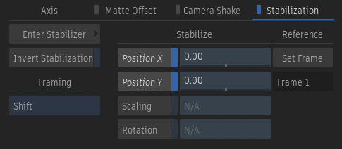

Stabilization Settings
Enter Stabilizer button
Enable to enter the Stabilizer editor.
Invert Stabilization button
Enable to apply an inverse of the stabilization data to recreate the original camera shake.
Framing Mode box
Select a method to fill or remove the area where the image has been shifted after stabilization.
Position X button
Enable to include the X-axis position in the stabilization.
Position X field
Displays the amount of stabilization data found in the animation channel for the X position.
Position Y button
Enable to include the Y-axis position in the stabilization.
Position Y field
Displays the amount of stabilization data found in the animation channel for the Y position.
Scaling button
Enable to include scaling in the stabilization.
Scaling field
Displays the amount of stabilization data found in the animation channel for scaling.
Rotation button
Enable to include the rotation in the stabilization.
Rotation field
Displays the amount of stabilization data found in the animation channel for rotation.
Set Frame button
Enable to set the current frame as a reference frame that has no transformation data.
Reference Frame field
Displays the frame number of the reference frame that has no transformation data. Non-editable.
