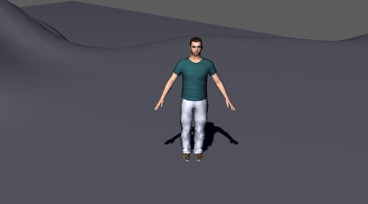

Result of a CreateEntity layout node
The CreateEntity node lets you add a new entity from a Golaem character file.
Note that this node doesn't need any prior selection node, and works as a selector for the newly created entity.
This node has some limitations: entities that use a CreateEntity can't be ground adapted the same way that other entities, and only the "Offset on Ground" and "Offset and Ori on Ground" are available.

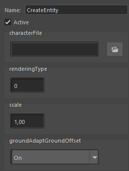

Node parameters
Parameters are accessible by clicking on the node in the Layout Graph Edition panel:
PlayAnimation node parameters
| Name | Name of the node |
| Active | Whether the node is active or not |
| Character File | Golaem character file (.gcha) to use for the created entity |
| renderingType | Rendering type to use for the new entity |
| scale | Scale to use for the new entity |
| groundAdaptGroundOffset | True to change the ground adaptation mode to the "Offset on Ground" mode |
