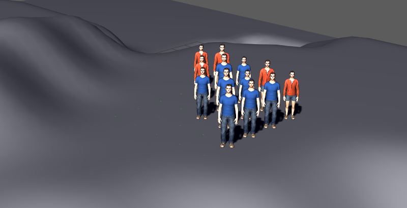

Result of a Kill layout node
The Kill node lets you erase the affected Entities.
