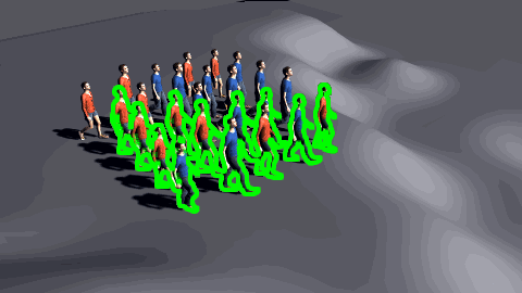

Frame Warp
Result of a Frame Warp layout node
The Frame Warp node lets you modify cache frame playback speed for affected Entities.

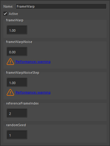

Node parameters
Parameters are accessible in the Attribute Editor panel by selecting the node in the Layout Graph Edition panel:
Frame Warp node parameters
| Name | Name of the node |
| Active | Whether the node is active or not |
| Frame Warp | The speed ratio at which selected entities are replaying the cache frames |
| Frame Warp Noise | Amount of noise around the frame warp value (each entity will randomly pick a value between frameWarp - 0.5*frameWarpNoise and frameWarp + 0.5*frameWarpNoise ) Performance might be affected depending on this value. Check the Layout Editor Performances page for more information. |
| Frame Warp Noise Step | Step value for the noise parameter. For instance, for a noise of 4 and a step of 0.5, noise values will only be -2 / -1.5 / -0.5 / 0 / 0.5 /1.5 /2. Limiting the number of different noise values allows better performances (it needs to load less input frames) Performance might be affected depending on this value. Check the Layout Editor Performances page for more information. |
| Reference Frame Index | Reference frame from which frames are warped |
| Random Seed | Random seed to use to pick a noise value per entity. Changing this parameter will change the distribution of noise on the entities |
