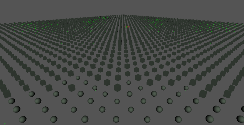

Replace LOD Distances

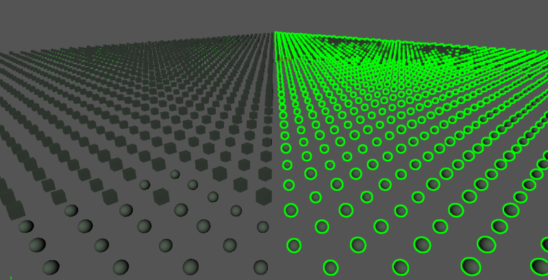

Result of a Replace LOD Distances layout node
The Replace LOD Distances node lets you replace the LOD distances of affected Entities to change the geometry used depending on the distance to camera.
