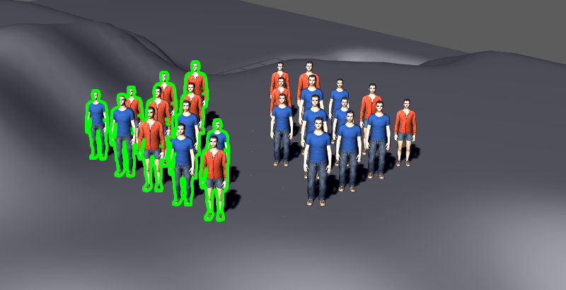

Result of a Translate layout node
The Translate node lets you translate the affected Entities.

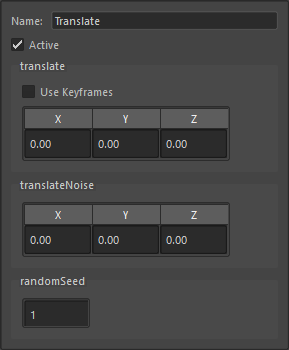

Node parameters
Parameters are accessible by double-clicking on the node in the Layout Graph Edition panel:
Translate node parameters
| Name | Name of the node |
| Active | Whether the node is active or not |
| Translate | Translation distance to apply This parameter is keyframable, check the page explaining how to handle the keyframes in Maya |
| Translate Noise | Amount of noise around the translate value (each entity will randomly pick a value between translate - 0.5*translateNoise and translate + 0.5*translateNoise ) |
| Random Seed | Random seed to use to pick a noise value per entity. Changing this parameter will change the distribution of noise on the entities. |
