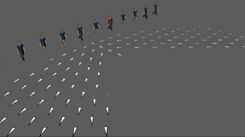

Trajectory Vector Field
Result of a Vector Field layout node
The Vector Field node lets you alter the trajectory of the affected Entities with a user drawn Vector Field.

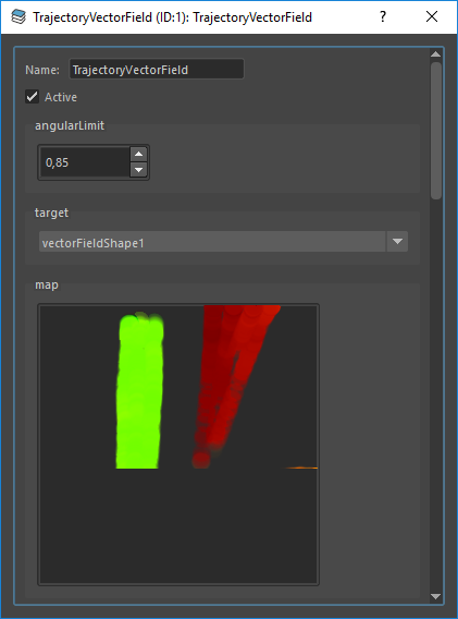

Parameters are accessible by double-clicking on the node in the Layout Graph Edition panel:
Vector Field node parameters
| Name | Name of the node |
| Active | Whether the node is active or not |
| Angular imit | The maximum angle (in °) that the entity can rotate per frame. A value of 0 means the entity can't turn to follow the vector field. |
| Target | The vector field target in the scene. This parameter will be used to automatically refresh all the following parameters. |
| Map | This parameters should not be edited directly by the user. It will be automatically updated when the target vector field changes. Contains the vector field map. |
| Geo Vertices | This parameters should not be edited directly by the user. It will be automatically updated when the target vector field changes. Contains the geometry vertices on which the vector field map is applied. |
| Geo Normals | This parameters should not be edited directly by the user. It will be automatically updated when the target vector field changes. Contains the geometry normals on which the vector field map is applied. |
| Geo UVs | This parameters should not be edited directly by the user. It will be automatically updated when the target vector field changes. Contains the geometry UVs on which the vector field map is applied. |
| Geo Triangles | This parameters should not be edited directly by the user. It will be automatically updated when the target vector field changes. Contains the geometry triangles on which the vector field map is applied. |
