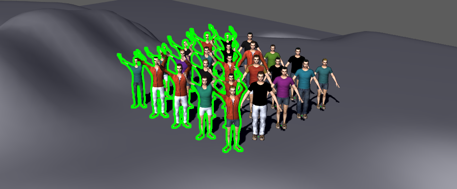

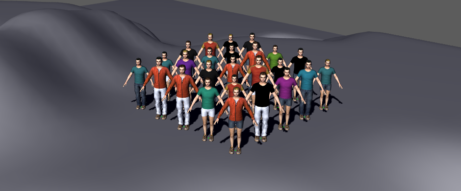

Result of a PlayAnimation layout node
The PlayAnimation node lets you play an animation file on the affected Entities.

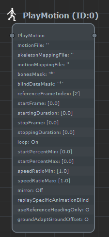

Add node
- Drag the PlayAnimation node icon
from the Nodes Library panel and drop it in the Layout Graph Edition panel - Hit the Tab key in the Layout Graph Edition panel and select the PlayAnimation option in the dropdown menu that appears
PlayAnimation node in the Layout Graph Edition panel

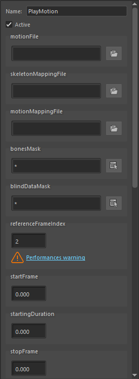

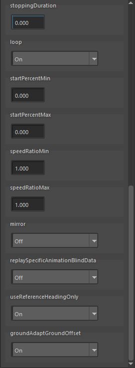

Node parameters
Parameters are accessible by clicking on the node in the Layout Graph Edition panel:
PlayAnimation node parameters
| Name | Name of the node |
| Active | Whether the node is active or not |
| Animation File | Animation file to play. It can be any format supported by Golaem (gmo, fbx, usd, bvh) |
| Skeleton Mapping File | Skeleton mapping file for the given animation, if necessary. |
| Motion Mapping File | Motion mapping file to replay the given animation, if necessary. |
| bonesMask | List of bones to play on the character. Star ( * ) wildcard is authorized at the beginning or/and end of names (i.e. mouth*, *eye, etc.). Separate the bones names by comma ( , ), leading and trailing spaces will be ignored. Use the * wild card to use all bones. Names are NOT case sensitive (compared as lowercase).. |
| blindDataMask | List of Blind Data or Blend Shape to play on the character. Star ( * ) wildcard is authorized at the beginning or/and end of names (i.e. mouth*, *eye, etc.). Separate the Blind Data / Blend Shape names by comma ( , ), leading and trailing spaces will be ignored. Use the * wild card to use all Blind Data / Blend Shape. Names are NOT case sensitive (compared as lowercase). |
| Reference Frame Index | Frame at which the entities will be at the same transforms than before applying the Play Animation node |
| startFrame | Frame at which the Play Animation node start to modify the entity's posture |
| startingDuration | Duration of the blending from the cache to the animation after the startFrame |
| stopFrame | Frame at which the Play Animation node stops to modify the entity's posture |
| stoppingDuration | Duration of the blending from the animation to the cache after the stopFrame |
| loop | True to loop the animation, false to freeze at the last frame |
| startPercentMin | Randomly set the Start Percent value between the specified "Start Percent Random Min" and "Start Percent Random Max" bounds |
| startPercentMax | Randomly set the Start Percent value between the specified "Start Percent Random Min" and "Start Percent Random Max" bounds |
| speedRatioMin | Randomly set the Speed Ratio value between the specified "Speed Ratio Random Min" and "Speed Ratio Random Max" bounds |
| speedRatioMax | Randomly set the Speed Ratio value between the specified "Speed Ratio Random Min" and "Speed Ratio Random Max" bounds |
| mirror | Mirror the animation. For mirror animation to work properly, the mirror must be correctly configured on the skeleton mapping, as explained on this page. |
| useReferenceHeadingOnly | True to discard the bank and attitudes orientations of the entity at the reference frame, false to take the full 3d orientation into account |
| groundAdaptGroundOffset | True to change the ground adaptation mode to the "Offset on Ground" mode |
