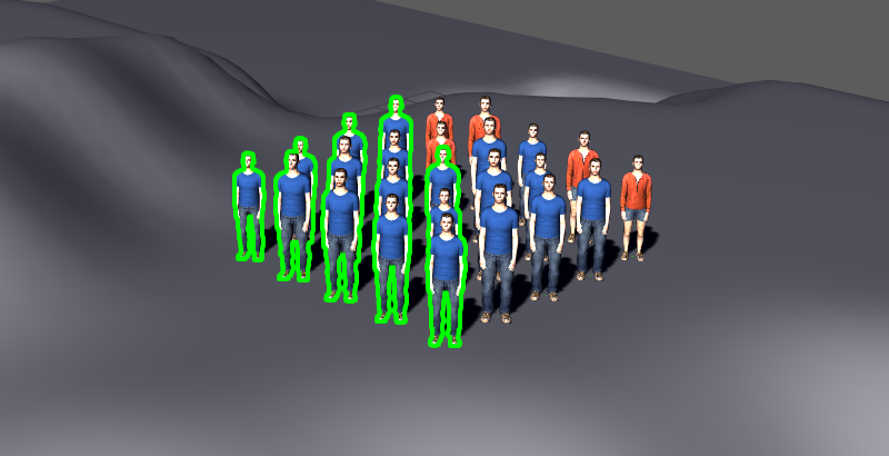

Set Mesh Assets
Original, and result of a SetMeshAssets layout node, picking left
entity assets and setting assets on all entities
The *SetMeshAssets *node lets you override the full set of Mesh Assets for affected entities. It is meant to duplicate all mesh assets from a specific entity to others.
