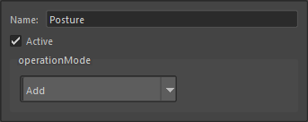

Parameters are accessible by double-clicking on the node in the Layout Graph Edition panel:
Scale Range node parameters
| Name | Name of the node |
| Active | Whether the node is active or not |
| Operation Mode | Mode of storage for the modified bone's position and orientation:

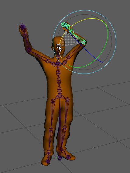

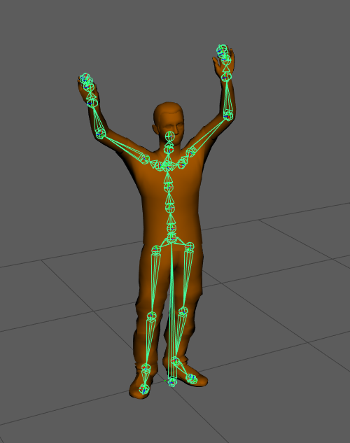

The Posture node lets you edit a posture in cache by creating a fully editable Maya skeleton with the correct cache posture keys. To see the skeleton posture in Maya, simply right click on the Posture node in the layout and click on the "Create Posture Node" contextual menu . When clicked, the node should create a Crowd Cache Posture in the Maya view. The Crowd Cache Posture references the cache and contains a fully editable Maya skeleton.
The Crowd Cache Posture can be deleted at anytime, modifications will be kept stored in the corresponding Layout node.
Changes on the editable Maya skeleton should be immediately seen:

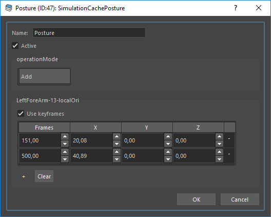

- as parameters in the layout graph:
A new parameter appears when editing a bone on the Maya skeleton. It
contains the name and index of the edited bone, and the type of
operation it performs (localOri)
The new parameter is also seen in the Posture parameters, with
keyframes if there are. Values can be edited directly here too.

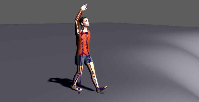

- applied to the cache posture in the Maya view:
Editing the skeleton bone's orientation is immediately visible on the
layout cache previz (the orange mesh)

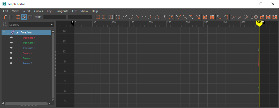

In this mode, Maya keyframes are only created for frames that already are in the Golaem cache. If the time was never changed since the cache import, chances are that only 1 frame is already cached, so the Graph Editor will only show a single key:
One single key frame

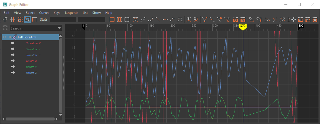

But as frames are loaded into the Golaem cache, they keyframes will automatically be added to the Maya skeleton:
After the timeline was played, most keyframes are now present
