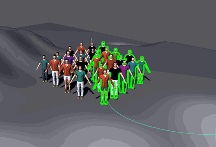

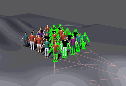

Result of an Edit Trajectory layout node in trajectory (middle) and mesh (right) modes
The Edit Trajectory node lets you edit the trajectory of the affected Entities.

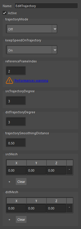

Node parameters
Parameters are accessible by double-clicking on the node in the Layout Graph Edition panel:
Edit Trajectory node parameters
Name Name of the node
Active Whether the node is active or not
Trajectory Mode
True to consider the Src as a single line trajectory.
False to consider the Src as a surface mesh.
Keep Speed On Trajectory
This parameters is only used when in trajectory mode
When On, the entity's speed is used to move along the trajectory. So if the destination trajectory's length is different than the source trajectory, the entity will take more or less time to reach its end.
When Off, the entity will take the current ratio position on the source trajectory and use it to compute the position on the destination trajectory. The number of frames it takes to travel along the destination trajectory will be exactly the same as it is on the source trajectory.
Reference Frame Index
The frame at which the entity's offset to the source trajectory will be computed to build the final entity's trajectory
Src Trajectory Degree
Degree of the NURBS curve to use for the source trajectory.
Should match the Degree option from the Maya nurbsCurve object for better results (it will automatically matched when importing the curve from a rigth click -> import selection as source).
Dst Trajectory Degree
Degree of the NURBS curve to use for the destination trajectory.
Should match the Degree option from the Maya nurbsCurve object for better results (it will automatically matched when importing the curve from a right-click -> import selection as destination).
Trajectory Smoothing Distance
The entity position and orientation on the curve is estimated by using a segment which extremities are projected on the curve, while the entity's position is set in the middle of the segment. This helps smoothing hard angles on the trajectory.
This parameter gives the distances ahead and behind that forms this segment.
Src Mesh/Curve The vertices that forms the source mesh or trajectory. This is usually not filled by hand, but rather by a right click on the node and Import selection as src mesh/trajectory
Dst Mesh/Curve The vertices that forms the destination mesh or trajectory. This is usually not filled by hand, but rather by a right click on the node and Import selection as dst mesh/trajectory

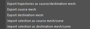

There are a few other option available when right clicking on the edit trajectory node:
Available options on a right click on the node
Export trajectories as source/destination mesh Will export the entities' trajectories as a mesh that can be used as base for user deformation
Export source mesh Will export the current src mesh attribute as a Maya mesh
Export destination mesh Will export the current dst mesh attribute as a Maya mesh
Import selection as source mesh/curve Will import the current Maya selected object as the src mesh attribute
Import selection as destination mesh/curve Will import the current Maya selected object as the dst mesh attribute
