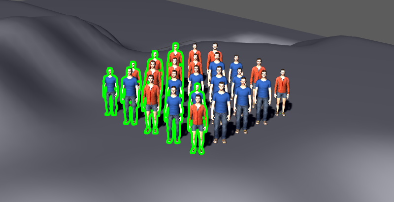

Result of an Unkill layout node
The Unkill node lets you un-erase the affected Entities. It has no effects on entities that were not previously deleted by a Kill node.
