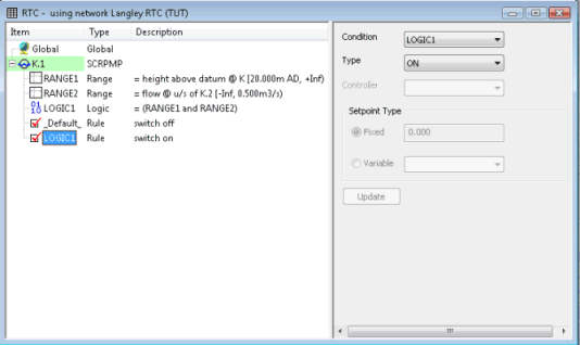

RTC Window Editor - Rule Pane
A Rule controls the setpoint of a Regulator. When the coditions on which a rule depend are TRUE the rule takes effect.
The Rule pane contains the following fields:
Condition
The label of a Range or Logic condition previously defined for this regulator or included in the Global definitions. If the Condition is blank, the rule is assumed to be TRUE.
The last TRUE rule for a regulator will be the active rule at a particular time during the simulation
Type
The Rule Type defines the way in which the rule operates on the regulator. Rule types are:
CTRL
Control
This rule uses a local controller or an increment rule
POS
Position
This rule directly sets a value of the setpoint for the regulator
ON
Switch on
This rule can only be used with pumps
OFF
Switch off
Controller
For a rule using an indirect control or an increment rule this is the label of the controller to be used. The controller record must have already been defined for this regulator or in the Global section
Setpoint Type: Fixed
For a control rule using a PID controller or for a POS rule this is the required value of the setpoint.
For a control rule using an INC controller this is the increment to be applied to the setpoint for every measurement interval that the rule applies.
Any value you enter in the variable setpoint field overrides the value you give in this field.
Setpoint Type: Variable
The name of a previously defined range, variable or table. The value of the range, variable or table is used as the setpoint.
If you leave this field blank the program uses the fixed setpoint given in the Setpoint field.
