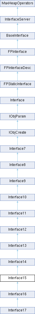

3ds Max C++ API Reference
Extends Interface14 Client code should retrieve this interface using GetCOREInterface15. More...
