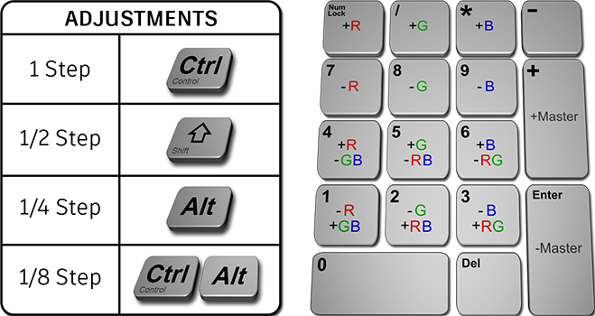

To use the printer lights grading style:
  1. Holding down a modifier key, press a key on the keypad to modify the RGB channels.
    So Ctrl+8 in Log mode decreases the brightness in the Green by 1 step. Ctrl+Alt+8 in the same mode decreases the brightness in the Green by 1/8th of a step.
The size of a single step is intended to allow you to quickly arrive at roughly the desired grade. At that point the fractional steps may be used to refine your adjustment.
The size of a step depends on the MasterGrade Image Type setting:
Image Type SettingOne Printer Lights Step Equals...
Log mode1.0 Brightness units
Video mode0.02 Offset units
Scene-linear mode0.1 Exposure units, equivalent to 1/10th of a stop
Within the Printer Lights grading style, there are two methods to control the RGB channels: the Lustre style, and the Flame style.
Lustre Style
  • RGB adjustments only affect a single channel, independent of the other 2 channels.
  • Results in a shift in brightness along with the balance change.
  • Uses the top 6 keys of the keypad: Num Lock, /, *, 7, 8, 9
Flame Style
  • Colour balance adjustments are better decoupled from Master adjustments.
  • An increase in one channel is balanced by a decrease in the other channels to minimize the brightness shift.
  • The Flame style uses the same method of colour balance adjustment as the one used in the Colour Wheels.
  • Uses keypad keys 1 through 6.
Finally, you can affect all three channels simultaneously with the master adjustment.
Master adjustments move all three RGB channels in sync.
  • +: +Master
  • Enter: -Master
