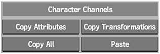

Copying and Pasting Character Channels
You can copy character attributes, transformations, or both, from one character and paste them onto a selection of others.
To copy and paste character channels:
  1. Select the text from which you want to copy the attributes or transformations.
  2. In the Character Channels section of the Text menu, click Copy Attributes, Copy Transformations, or Copy All.
  3. Select the text to which you want to paste the attributes or transformations.
  4. Click Paste.
