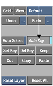

To animate text automatically:
  1. In the Text Animation menu, enable Auto Key.
  2. Go to the first frame in the clip.
  3. With the Attribute controls, set the attributes and transformation properties.
  4. Navigate to another frame in the clip and add more attributes and transformation properties according to the effect you want to produce.
  5. Make modifications as required.
  6. Click Play to view the result.
    When you play the clip, the animation moves from the first frame to the last.
