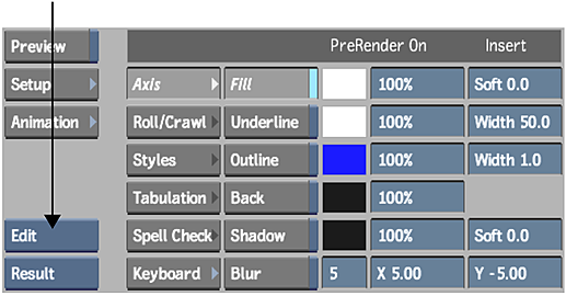

  1. From the Text Mode box, select Edit.
    Tip: Use Edit mode to type text strings, select text, edit text in layers, and modify text attributes. Press F1 to switch between Edit and Move modes. The message bar displays the current mode.

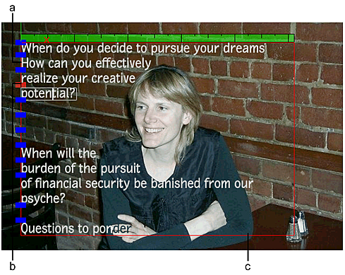

    Notice that each paragraph has its own coloured boundary and a paragraph tag that is a coloured rectangle in the upper-left corner of the paragraph. In Edit mode, a selected paragraph's boundary is white.
    (a) Blue indicates paragraphs in text layer (b) Red indicates currently selected paragraph, which has a paragraph boundary (c) Layer boundary is shown in red

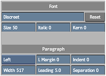

  4. In the Paragraph and Font menus, set properties.
