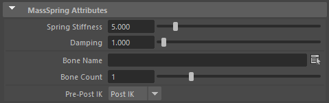

MassSpring Attributes
Spring Stiffness
The spring stiffness. Higher stiffness leads to more rigid behaviors.
Damping The damping coefficient, which must always be less than the spring stiffness (or resonance will occur). Higher damping avoids oscillations, whereas lower damping allows them.
Bone Name
The name of the bone chain ending bone : the "leaf" bone of the chain.
Bone Count The skeleton bone count in the bone chain, impacted by the effect : the last bone of the chain will be the bone name, and it will take (bone count -1) parents in its influence
Pre-Post IK The Mass Spring behavior IK requests can be inserted before or after IK / Look At behaviors requests. The default is after other IK requests (Post IK)

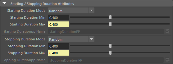

Starting / Stopping Duration Attributes
The Starting / Stopping Duration value determines the time (in seconds) during which the mass spring effect goes from inactive to fully active (or vice versa). This time can be used to transition smoothly between two behaviors.
Starting / Stopping Duration Mode
This attribute allows a choice of two modes :
  • Random: Randomly set the Starting / Stopping Duration value between the specified "Starting / Stopping Duration Min" and "Starting / Stopping Duration Max" bounds (this attribute is influenced by the random seed of the Crowd Manager)
  • Per-Particle Attribute: Use the "Starting / Stopping Duration Name" attribute to get the name of the float per-particle field of the relative particle system, containing the Start Percent value.
The Starting / Stopping Duration value is in seconds.
Starting / Stopping Duration Min See Random option of the Starting / Stopping Duration Mode above
Available only when the Starting / Stopping Duration Mode is set to "Random"
Starting / Stopping Duration Max See Random option of the Starting / Stopping Duration Mode above
Starting / Stopping Durationpp Name Name of the float per-particle field of the relative particle system, containing the Starting / Stopping Duration Mode value which will be used (for more explanation about how to use ppAttributes, see ppAttributes Handling)
Starting / Stopping Duration value is set to 0 if the ppAttribute name is empty or invalid
Available only when the Starting / Stopping Duration Mode is set to "Per-Particle Attribute"
