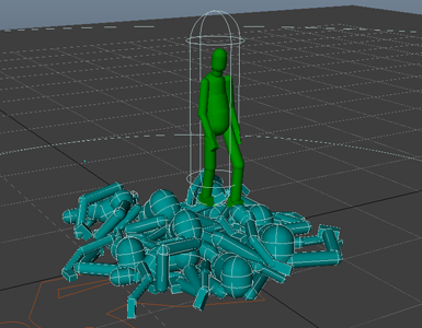

Example of a ground adaptation performed by a Character Controller

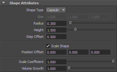

Shape Attributes
| Shape Type | Collision Controller shape type, can be Box or Capsule |
| Size | If the Shape Type is set to Box, it specifies the length, width and height of the shape |
| Radius | If the Shape Type is set to Capsule, it specifies the radius of the shape |
| Height | If the Shape Type is set to Capsule, it specifies the height of the shape |
| Step Offset | Defines the maximum height of an obstacle which the character can climb. A small value will mean that a Box-shaped Character Controller gets stuck and cannot walk up stairs etc, a value which is too large will mean that the character can climb over unrealistically high obstacles. |
| Scale Shape | If checked, the Size, Radius, Height and Position Offset attributes will be multiplied by the scale of the Entity (defined in the Entity Type node) |
| Position Offset | Offset between the Character Controller shape and the Root bone of the Entity (by default, the Capsule or the Box are centered on the Character root bone) |
| Scale Coefficient | Additional scale to apply on the Character Controller |
| Volume Growth | Scale factor of space around the Controller which will be cached to improve performance. |
A convenient way to check if the Shape is conveniently sized and placed is to used the Display Collision Shapes option of the Physics Locator.

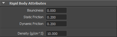

Rigid Body Attributes
| Bounciness | Restitution coefficient |
| Static Friction | Friction when the Character Controller is at rest |
| Dynamic Friction | Friction when the Character Controller is in motion |
| Density | Density |

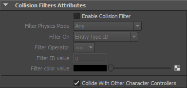

Collision Filters Attributes
| Enable Collision Filters | If checked, the physics objects described in the filters will NOT be taken into account in the collision process |
| Filter Physics Mode | Collisions will not be detected with physics parts that are of the given physics mode (see the Physicalize Mode parameter of the Physicalize Behavior for more information on physics modes). |
| Filter On | This lets you filter the physics parts which will not be detected.
| Filter Operator | Comparison operator (equal, greater than…) |
| Filter ID Value | ID for the filter (to see how to set an ID, check the EntityType , the Crowd Rigid Body and the Physicalize Behavior). |
| Filter Color Value | Color for the filter (to see how to set a color, check the EntityType, the Bone Physics Properties part of the Character Maker, and the Crowd Rigid Body). |
| Collide With Other Character Controllers | If checked, the other Character Controllers of the scene will be taken into account in the collision process |

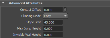

Advanced Attributes
| Contact Offset | Specifies a skin around the object within which contacts will be generated. |
| Climbing Mode | Controls if a Character Controller slides or not on a non-walkable part. This is only used when Slope Limit is non zero. |
| Slope Limit | The maximum slope which the character can walk up. |
| Max Jump Height | Maximum height a jumping character can reach. This is only used if Invisible Wall Height is non zero |
| Invisible Wall Height | Height of invisible walls created around non-walkable triangles |
