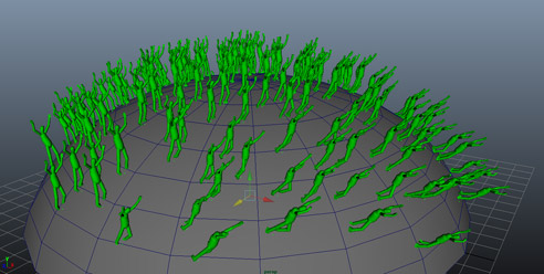

It is important to notice that the Adapt Orientation behavior is a post process that only changes the orientation of the root bone of the Entity. Make sure that this bone is correctly placed depending on your Entity (i.e. between the feet for a human morphology, at the hips for a bird...).
Example of Entities oriented according to the terrain normal

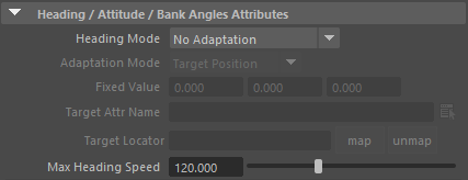

Heading / Attitude / Bank Angles Attributes
Those attributes are only available if the Orientation Mode is set to Heading / Attitude / Bank Angles.
Heading Attributes
Heading Mode
Mode defining the heading orientation adaptation:
  • Velocity Based: computes the character orientation automatically based on particle velocity
  • Fixed Value: enables to specify an orientation manually
  • Per Particle Attribute: the name of the Per Particle Attribute from which the values will be read
  • Golaem Attribute: the name of the Golaem Attribute from which the values will be read
  • Locator: computes the orientation so that the character faces a given locator
Adaptation Mode
  • Target Position: The input fixed value, or per particle attribute, is a target position that the character must face (see image below)
  • Direction: The input fixed value, or per particle attribute, is a Direction vector (see image below)
Fixed Value Position or direction value for the Fixed Value mode
Target Attr Name Name of the vector Per Particle or Golaem Attribute from which to load values if the Per Particle Attribute or Golaem Attribute mode is active.
Target Locator  Locator faced by the Entity if the Locator mode is used
Max Heading Speed Maximum adaptation of the heading (in °/sec)
Left: Target Position Adaptation mode: all Entities face the specified world position (1, 0, 0) - Right : Target Direction Adaptation Mode: all Entities face in the direction of the X axis (1, 0, 0)

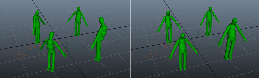

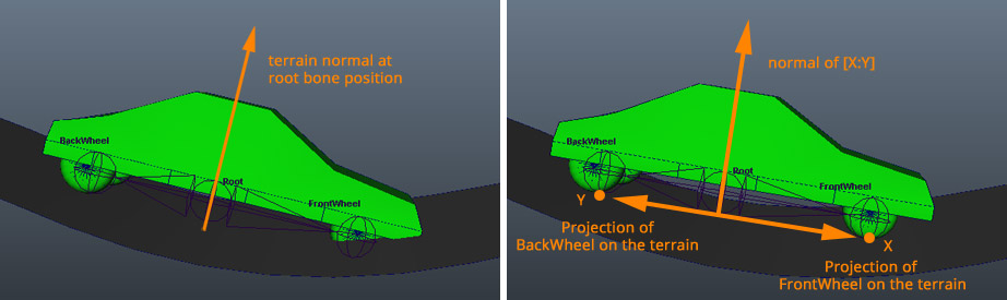

  • Terrain Based: computes the attitude depending on the ground normal at the root position (see example below). This mode is usually useful for biped Entities
  • Bones and Terrain Based: computes the attitude depending on the projection on the ground of a Front Bone and a Back Bone (see example below). This mode is usually useful for rigid Entities (bikes or cars).
Front Bone Id Id of the front bone to use as adaptation reference for the Bones and Terrain Based mode. The bone Id can be found in the Skeleton Panel when opening the Character File (.gcha) with the Character Maker Tool.
Back Bone id Id of the back bone to use as adaptation reference for the Bones and Terrain Based mode. The bone Ids can be found in the Skeleton Panel when opening the Character File (.gcha) with the Character Maker Tool.
Max Attitude Speed Maximum adaptation of the attitude (in °/sec)
Difference between Terrain Based mode (left) / Bones and Terrain Based mode (right)

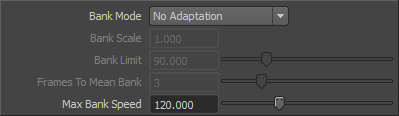

Bank Attributes
Bank Mode If the mode is changed, the Entity will also lean in towards the center of the curvature of the curve that it travels along (like a motorcycle going around a corner). No banking occurs when the orientation does not change.
The final banking orientation depends on how much does the orientation vary between two frames. Banking can be adjusted using Bank Scale and Bank Limit.
Bank Scale
If you increase the Bank Scale, then the banking effects will be more pronounced. For example, if the Bank Scale is set to 2, then the object will bank twice as much as the default that is computed. This parameter is the same as in Maya.
A negative number can be set for Bank Scale. This will cause the object to lean out, away from the center of the curvature, rather than in towards the curvature. For example, you could use this in animating characters thrown from side to side in a roller coaster.
Bank Limit Bank Limit lets you restrict the amount of leaning. For example, the Bank Scale may be increased to obtain pronounced effects, but then this may cause the object to lean too much where the curve is very curved. This option will limit the leaning to the given amount. This parameter is the same as in Maya.
Frames To Mean Bank Banking will be based on a mean of n last frames.
Max Bank Speed Maximum adaptation of the bank (in °/sec)

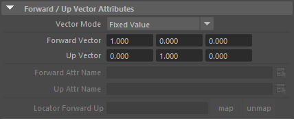

Forward / Up Vector Attributes
Those attributes are only available if the Orientation Mode is set to Forward / Up Vectors.
Vector Mode
3 modes are available to set the Forward / Up Vector Mode:
  • Locator: enables to specify a Locator from which the values will be read
Forward Vector / Up Vector
Forward and Up vector values for the Fixed Value mode
Forward Attr Name / Up Attr Name
Locator Forward Up Forward and Up vector values will be read from the Locator orientation
