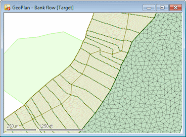

Each river bank may be connected to a single object of type River Reach, Storage Area or 2D Zone into which flow from the river reach can spill.

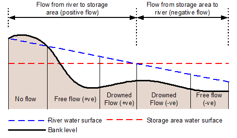

Flow over the bank is calculated as a flow over a jagged or irregular weir. The flow over the bank is calculated by splitting the calculation into determining flows over segments using an integrated form of the weir equation for dry, free and drowned, forward and reverse modes. These flow and associated matrix coefficients are then summed together subject to stability constraints, to give values over the entire bank.

The levels used to determine spill flow come from the river reach section points, mesh element points along the bank and from any computational nodes (inserted according to the space step settings in the simulation parameters).

Mode 0 - Zero Flow
Condition
The upstream (highest) water level is below the bank level defined in the spill, or the water levels are above the bank level but almost exactly equal.

Mode 1 - Free Flow (positive sense)
Condition

Mode 2 - Drowned Flow (Positive Sense)
Condition

Mode 3 - Free flow (Negative Sense)
The same formulae apply as for mode 1 but with y21 interchanged with y11, and y12 interchanged with y22.
Mode 4 - Drowned flow - (Negative Sense)
The same formulae apply as for mode 2 but with y21 interchanged with y11, and y12 interchanged with y22.
