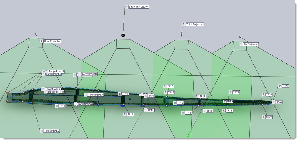

Set Up and Add Projectors
By dragging and dropping laser projectors into your 3D assembly layout, you can perform simulations on the laser data. These simulations tell you:
- Laser data and targets in the range for each laser projector
- If the current angle and position of the projector relative to the tool allows the projector to reach the correct parts of the tool
- If anything is in between the projector and the tool
- The best path for the projector to minimize flicker
