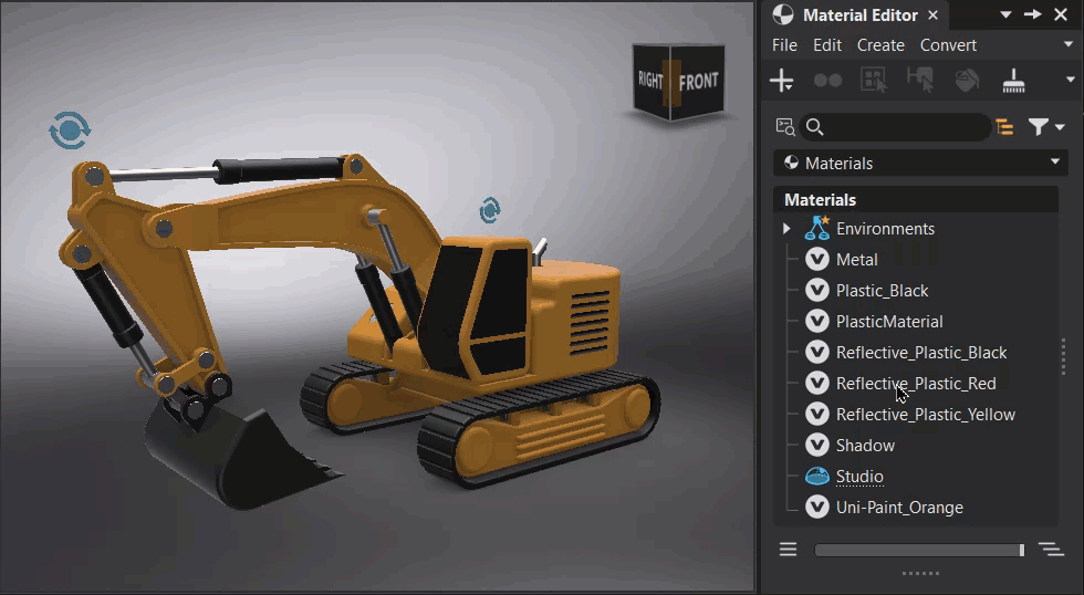

Video captions: Create a switch material and assign it to a geometry. As an aid, select the car paint material that is already assigned to the geometry. Upon calling up the Material Editor menu with the right mouse button, pick Select Nodes. Assign the switch material to the geometry by running the command, Apply To Select Nodes. Duplicate the car paint material multiple times and change each diffuse color as you feel. Subordinate the created car paint material via drag and drop to the switch material. Within a switch material, multiple different materials can be integrated and selected between them. The currently selected one is active, while all others remain inactive. The order of the materials can be changed via the command, Move Up and Move Down, after invoking the Switch Material menu with the right mouse button.

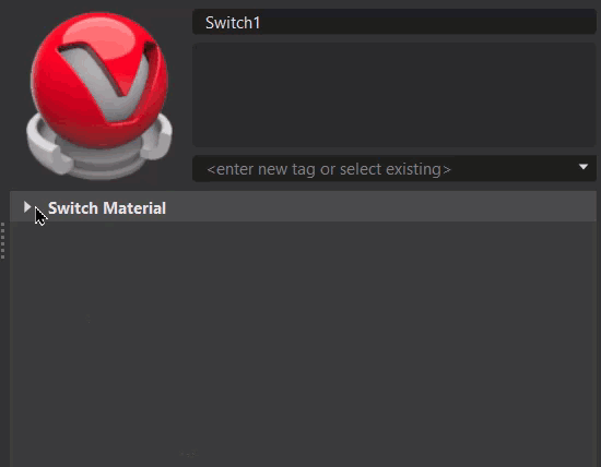

    Create a switch
  • From the editor's menu bar, select Create > Create Material > Switch to create an empty switch, in which materials can be dragged and dropped.
  • Select multiple materials, RMB-click and drag them onto geometry in the render view, and choose Add as Switch.

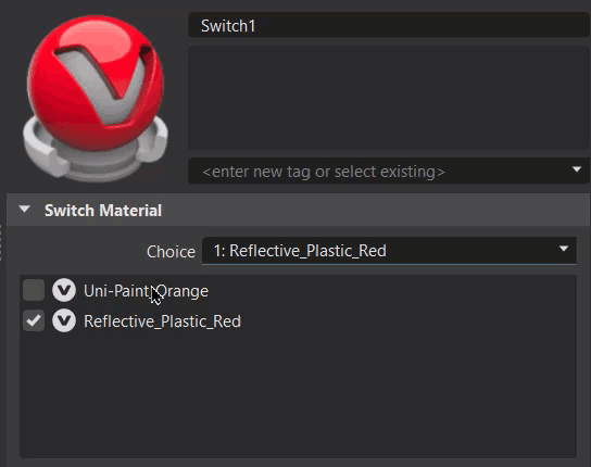

Assigning Multiple Material Variants to a Switch
To assign several material variants on creation, select them and then select Create Switch from Selection from the context menu.

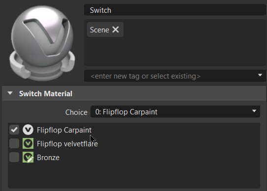

Attributes
When a switch is selected, its material variants are listed in the Attributes and Choice pulldown. However, if they aren't, click the section title. Adding a check next to a material variant makes it active, as does choosing one from the Choice pulldown, which defines which entry of the materials in the list is set to active.
List of switch material variants
Double-click a material variant to load its properties and click the switch tab to return to the switch and list of material variants.
