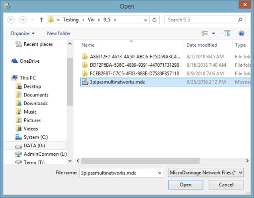

To import MicroDrainage network data
  1. Open the network to be updated.
  2. Select ImportModelfrom MicroDrainage data from the Network menu, and a standard Windows Open dialog is displayed.
  3. Select the .mdx file to be imported.
  4. Click Open.

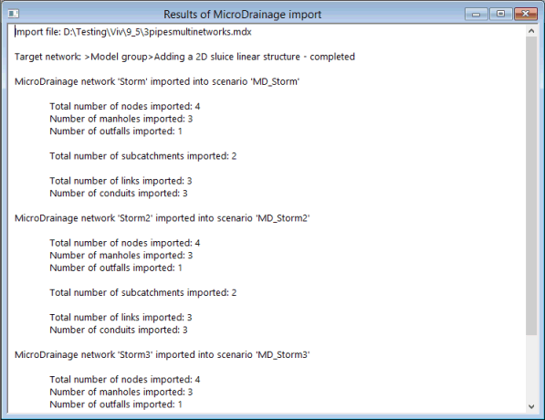

An import report will be displayed with any import errors or warnings. It will also include the full path of the mdx file which was imported together with the full path in the InfoWorks ICM tree of the target network.
Create New Node dialog
For an mdx file with a single MicroDrainage network, all data is imported into the currently selected scenario of the target network in InfoWorks ICM.
For an mdx file with multiple MicroDrainage networks, the data from each MicroDrainage network is imported into a different scenario in the target network. For example, a MicroDrainage network with name "XXXXX" the corresponding scenario in InfoWorks ICM is named "MD_XXXXX". If a scenario does not already exist, a new one will be created.
For each scenario the report provides the total number of imported objects of different types.
