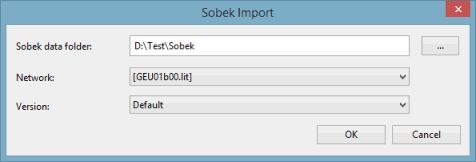

To import SOBEK network data
  1. Open the network to be updated.
  2. Select ImportModelfrom SOBEK network data from the Network menu, and the SOBEK Import dialog is displayed.
  3. In the SOBEK data folder field, enter the path to the folder which contains the network (LIT file) to be imported, or click to browse for the folder.
    When selected, the Network dropdown list is populated with all the network files in the selected folder.
  4. Choose a network from the Network dropdown list.
    When selected, the Version dropdown list is populated with all versions of the selected network file.
  5. Choose a version of the selected network from the Version dropdown list.
  6. Click OK to start the import.
An import log will be displayed with any import errors or warnings.
For details of the objects imported and any conversions made by the InfoWorks ICM Importer, see the Import Notes below.
