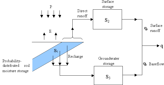

The Probability Distributed Model (PDM) is a general-purpose, lumped conceptual model for continuous rainfall-runoff simulation (Moore, 2007). The PDM model incorporated within InfoWorks ICM is based on the model developed by the UK Centre for Ecology and Hydrology (CEH) © 2000 NERC CEH Wallingford.
General form of the PDM rainfall-runoff model
