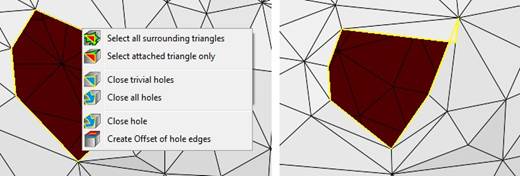

  1. Right-click a border edge on a hole and choose Create Offset of Hole Edges.
  2. Enter the offset distance which controls how far to offset the new triangles into the hole.
  3. Click OK.

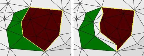

Left: Original mesh. Right: An offset of 1 mm is created.
Left: A selection of triangles before the offset. Right: The resulting offset.
