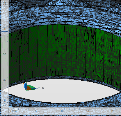

A highly irregular mesh is partly selected in preparation for remeshing.

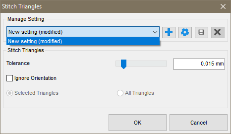

Actions available for interactive use come with a dialog that permits saving and recalling settings.
Create and save new settings as needed, even export and import them.
