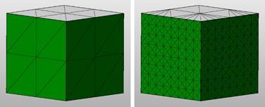

A mesh refinement has been applied to the selected surfaces of this cube.
