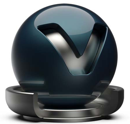

Measured Carpaint
This material type aligns to the measured material. It additionally enables adjusting the refraction index of the scanned material within its properties. Create this through the X-Rite Measured material.
Measured Carpaint
