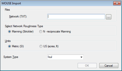

Import Network from MOUSE Data Dialog
The MOUSE Import Dialog is used when Importing MOUSE Network Data from text file.
The dialog is displayed when ImportModelfrom MOUSE text file is selected from the Network menu.
Mouse Import Text dialog
  1. Enter the path to the text file to be imported in the Network (TXT) box, or use the browse button to select a file from a Windows File Open dialog.
  2. MOUSE uses the Manning equation to represent roughness. In InfoWorks ICM, Manning values can be represented either as M = 1 / n or n. Use the Select Network Roughness Type radio buttons to select your preference.
  3. MOUSE files may contain data in SI (ha, m) or US (acre, ft) units. Use the Units radio buttons to select the appropriate units for the text file to be imported.
  4. Set the network system type to an appropriate value using the System Type combo box.
  5. Click OK to carry out the import. The OK button is only enabled if the name of an existing TXT file has been entered.
