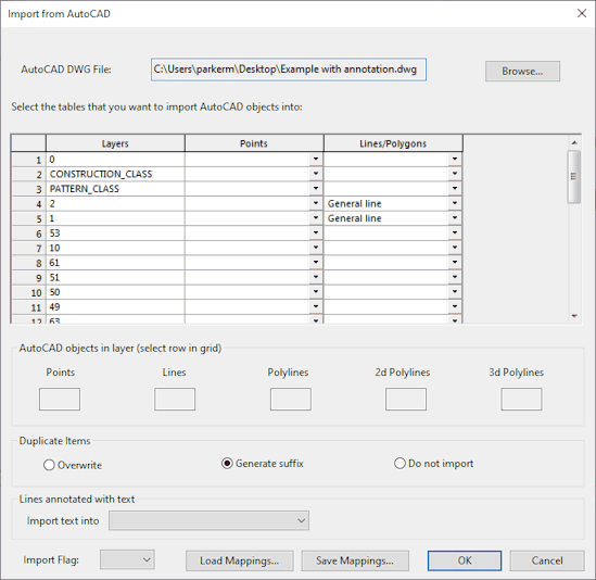

This dialog is used when Importing from AutoCAD DWG files.
It is displayed when Import
Import data from AutoCAD DWG is selected from the Network menu.
Dialog description
Dialog Field |
Description |
AutoCAD DWG File |
Displays the path of the DWG file to be used for import. Click Browse to select the file from a Window File Open dialog. |
Layers Grid |
The grid displays all layers in the selected DWG file. The grid is made up of three columns:
AutoCAD objects in layer |
Displays the number of each type of AutoCAD object in a layer highlighted in the Layers Grid. |
Duplicate Items |
There are three options for dealing with duplicate items:
Lines annotated with text |
Dropdown list containing all the available fields that annotations can be imported into. Permitted values are Length and user text and user number fields. Default is blank (no annotation import). |
Import Flag |
Dropdown list containing the available user-defined flags. Select a user defined flag for imported data. |
Load Mappings |
Load previously saved Point and Line mappings from AutoCAD configuration file into the Layers Grid. |
Save Mappings |
Save Point and Line mappings in the Layers Grid as an AutoCAD configuration file. |
