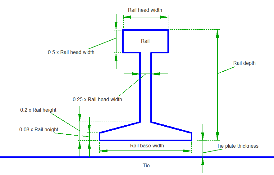

| Rail Head Width | Width of the rail head. | Numeric, non-negative |
2.72" 69 mm |
| Rail Depth | Depth of rail from top of rail to top of tie plate | Numeric, non-negative |
6.625" 168 mm |
| Rail Base Width | Width of the base of the rail | Numeric, non-negative |
5.5" 140 mm |

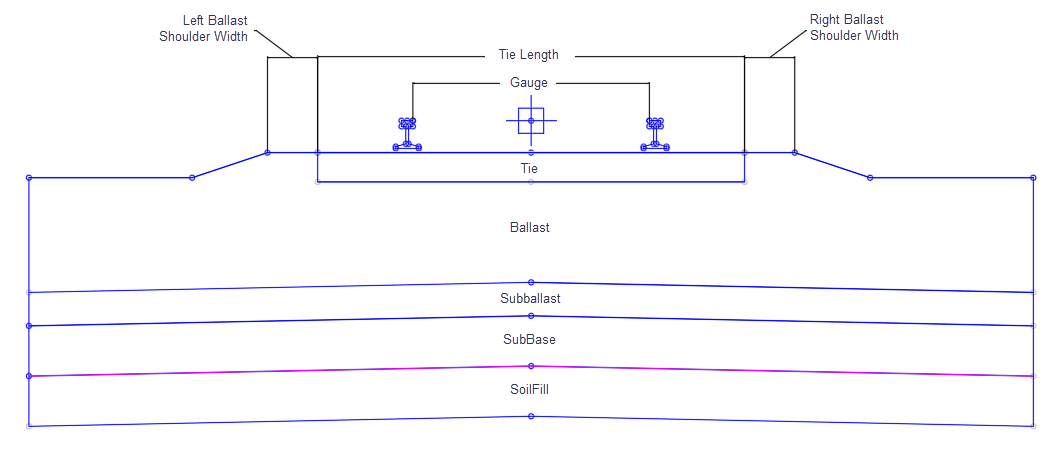

| Rail Base to Ballast | Distance from the bottom of the rail to the top of the ballast. If this value is equal to the tie plate thickness, then the top of the ballast is flush with the tops of the ties. | Numeric, non-negative |
1" 25 mm |
| Tie Length | Length of the tie (also known as sleeper). | Numeric, non-negative |
8.5' 2.59 m |
| Tie Depth | Depth of tie | Numeric, non-negative | 7"
178 mm |
| Minimum Ballast Depth | The minimum vertical distance between the bottom of the tie and the top of the subballast. The location of this minimum distance changes at different stages in cant. See Behavior below. | Numeric, non-negative | 12"
305 mm |
| Ballast Shoulder Width (Left and Right) | The distance from the end of the tie to the beginning of the ballast side slope. | Numeric, non-negative | 12"
305 mm |
| Ballast Side Slope (Left and Right) | The slope of the side of the ballast material. The slope of the top of the ballast material matches the slope of the tie that results from cant. | Slope, non-negative | 2:1 |
| Subballast Depth | The depth of the subballast material | Numeric, non-negative | 8"
203 mm |
| Subballast Top Slope (Left and Right) | The top slope of the left and right sides of the subballast with the centerline of the subassembly as the hinge point. | Slope, non-negative | 40:1 |
| Subballast Side Slope | The slope of the side of the subballast material. | Slope, non-negative | 2:1 |
| SubBase Extension | The distance from the toe of the subballast material to the beginning of the side slope of the subbase material | Numeric, non-negative |
0.5 ft 0.15 m |
| SubBase Slope | The slope of the side of the SubBase material. | Slope, non-negative | 1:1 |
| SubBase Depth | The depth of the SubBase material | Numeric, non-negative |
1 ft 0.30 m |
| Soil Fill Depth | The depth of the Soil Fill material | Numeric, non-negative |
1 ft 0.30 m |
| Soil Fill Slope | The slope of the side of the Soil Fill material. | Slope, non-negative | 1:1 |
| Soil Fill Extension | The distance from the toe of the subbase material to the beginning of the side slope of the Soil Fill material | Numeric, non-negative |
0.5 ft 0.15 m |
| Omit Rails | Prevents the rail points, links, and shapes from being drawn. | Yes/No | No |
| Omit Tie | Prevents the tie points, links, and shapes from being drawn. | Yes/No | No |
| Omit Ballast | Prevents the ballast points, links, and shapes from being drawn. If this option is set to Yes then the subballast is also not drawn. | Yes/No | No |
| Omit Subballast | Prevents the subballast points, links, and shapes from being drawn. If the Omit Ballast option is set to Yes then the subballast is not drawn regardless of this setting. | Yes/No | No |
| Omit SubBase | Prevents the subbase points, links, and shapes from being drawn. If the Omit Ballast or subballast option is set to Yes then the Sub Base is not drawn regardless of this setting. | Yes/No | No |
| Omit Soil Fill | Prevents the soil fill points, links, and shapes from being drawn. If the Omit Ballast, subballast, or subbase option is set to Yes then the soil fill is not drawn regardless of this setting. | Yes/No | No |

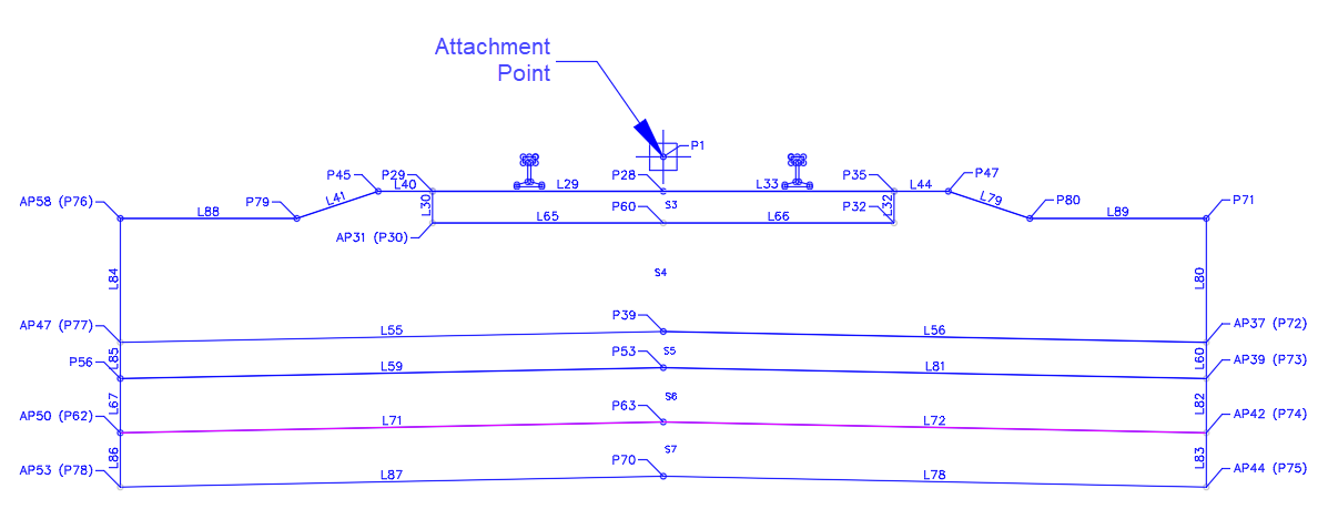

Point, Link, and Shape Codes
The following table lists the point, link, and shape codes for this subassembly that have codes assigned to them. Point, link, or shape codes for this subassembly that do not have codes assigned are not included in this table.
Point, Link, or Shape |
Code |
Description |
| P1, P4-P27, P58-P59 | Rail | Rail |
| P2 | Cl_Rail | Centerline of Rail |
| P3 | Gauge_Line,Rail | Gauge line (inside edge of top of rail) |
| P28-P32, P60 | Tie | Tie |
| P54-P55, P45, P47, P71-P72, P76 | Ballast | Ballast |
| P53, P73 | Subballast | Subballast |
| P62-P63, P74 | SubBase | SubBase |
| P70, P75, P78 | Soil Fill | Soil Fill |
| L1, L2 | Top_Rail, Rail | Top of rail |
| L3-L28 | Rail | Rail |
| L29-L33, L65-L66 | Tie | Tie |
| L40-41, L44, L55-L56, L63, L79-L80, L84, L88-L89 | Ballast | Ballast |
| L59-L60, L81, L85 | Subballast | Subballast |
| L67, L71-L72, L82 | SubBase | SubBase |
| L78, L83, L86-L87 | Soil Fill | Soil Fill |
| S1, S2 | Rail | Rails |
| S3 | Tie | Tie |
| S4 | Ballast | Ballast |
| S5 | Subballast | Subballast |
| S6 | SubBase | SubBase |
| S7 | SoilFill | SoilFill |
