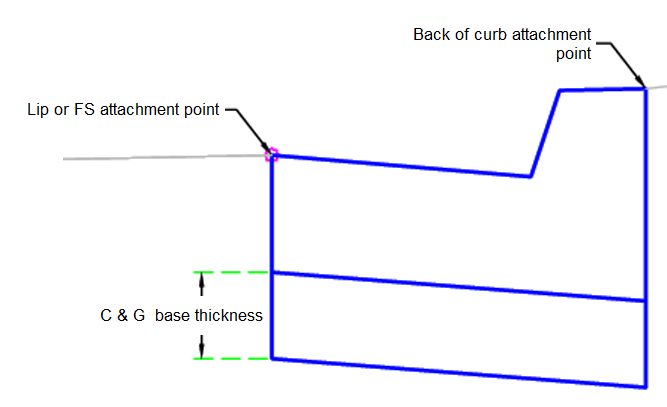

Curb and Gutter:

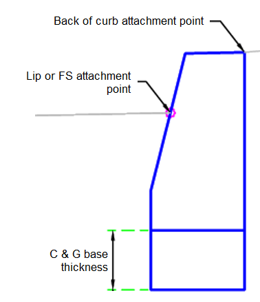

Curb:

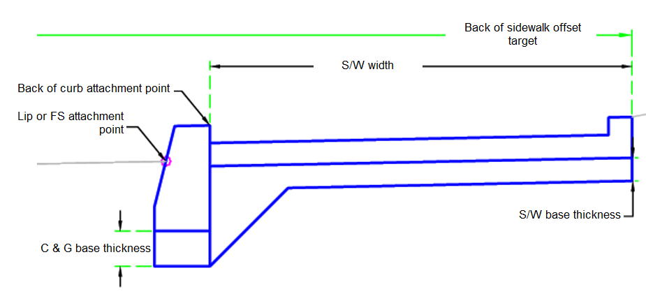

Boardwalk Sidewalk:

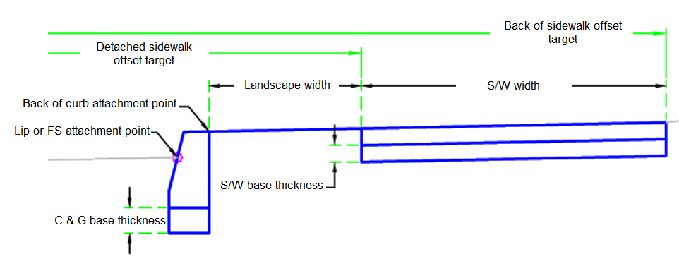

Detached Sidewalk:

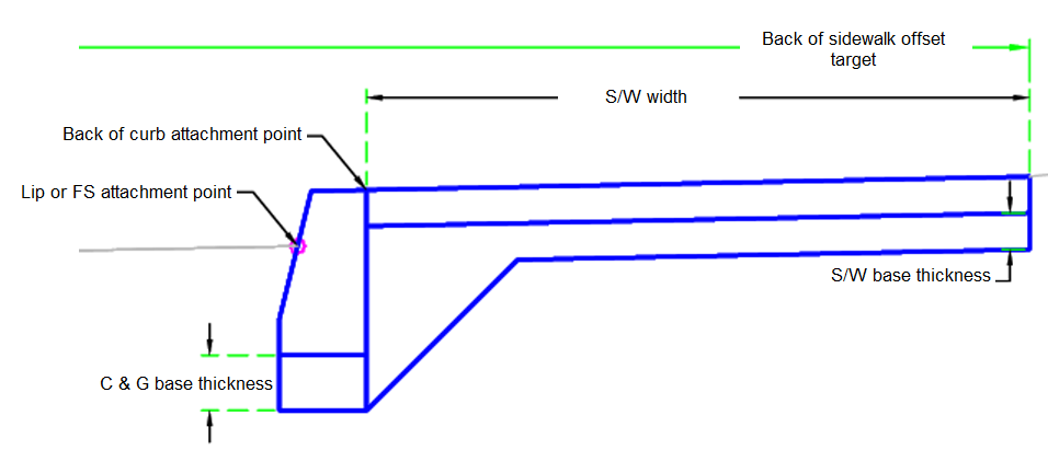

Integral Sidewalk:

The attachment point is at the Lip (or FS) and the Back of Curb. This component can be attached to either the left or right side.

Coding Diagram
Curb and Gutter:
Curb:
Boardwalk Sidewalk:
Detached Sidewalk:
Integral Sidewalk:
