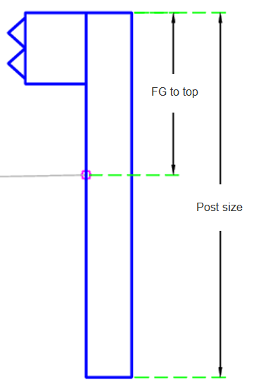

Behavior
The subassembly builds two rectangular shapes for the post and railing in addition to the rail shape. The post extends downward from the attachment point for a fixed distance below finish grade. The post extends upward the specified distance in the parameters.
Layout Mode Operation
In layout mode, this subassembly draws the post and rail with the fixed dimensions.

Coding Diagram
