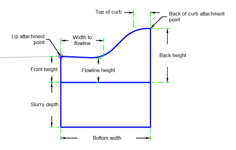

The RolledCurb subassembly inserts links for a rolled curb shape concrete curb-and-gutter with subbase.
The attachment point is at the curb lip or back of curb. This component can be attached to either the left or right side.

| Side | Specifies which side to place the subassembly | Left / Right | Right |
| Top of Curb | Top of curb | Numeric, positive |
4.5 in 100 mm |
| Back Height | Back height | Numeric, positive |
14.5 in 370 mm |
| Bottom Width | Bottom width | Numeric, positive |
24 in 600 mm |
| Front Height | Front height | Numeric, positive |
7 in 180 mm |
| Width To Flowline | Width to flowline | Numeric, positive |
11.5 in 300 mm |
| Flowline Height | Flowline height | Numeric, positive |
6.5 in 165 mm |
| SubBase Depth | Subbase depth | Numeric, positive |
12 in 300 mm |
| Attachment Point | Attachment point | Lip, BackCurb | Lip |

The curb and gutter links are inserted based on the Input Parameter dimensions. All dimensions must be positive, non-zero values.
The subassembly builds the shape for a simple curb and gutter, with the attachment point either at (a) lip of the gutter, or (b) the back of the curb.
