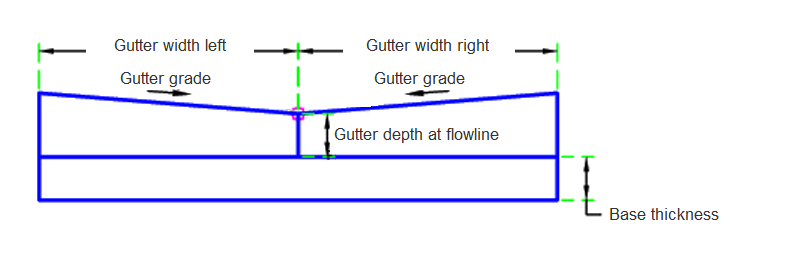

The CrossGutter subassembly inserts links to create cross gutter placed at an intersection.
Case 1: Both

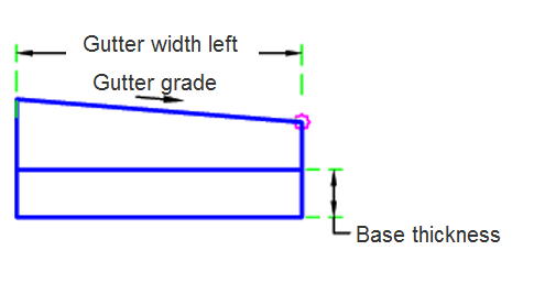

Case 2: Left
Case 3: Right
The attachment point is at flowline of the cross gutter. This component can be attached to either the left or right side.
Input Parameters
Parameter |
Description |
Type |
Default |
| Side | Specifies which side to place the subassembly | Left / Right | Right |
| Gutter Composition | Determines if the left, right, or both are built | Both / Left / Right | Both |
| Base Thickness | Thickness of base under gutter | Numeric, positive |
0.5 ft 0.15 m |
| Gutter Depth At Flowline | Depth of gutter at the flowline | Numeric, positive |
0.5 ft 0.15 m |
| Gutter Grade | Gutter grade | Numeric | 8 (%) |
| Gutter Width Left | Gutter width left | Numeric, positive |
3 ft 0.9 m |
| Gutter Width Right | Gutter width right | Numeric |
3 ft 0.9 m |

Behavior
The gutter links are inserted based on the input parameters. The targets may override the outside edge of the cross gutter on both the right and left sides. If the base thickness is greater than 0, then the base is built under the cross gutter.
