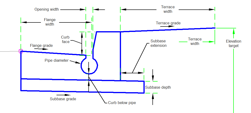

The CurbEmbPipe subassembly inserts links for a concrete curb with embedded pipe at the flowline. A terrace may be placed behind the curb and gutter.
The attachment point is at the flange point of the gutter.

Side |
Specifies to insert the subassembly either on the right or the left side of the attachment point. | Left/Right |
Right |
Flange Width |
Width from the flange of the gutter to the flowline. | Numeric, positive |
1.5 ft 0.5 m |
Flange Grade |
% slope of the gutter. | Numeric |
6 (%) |
Subbase Extension |
Width that the subbase layer extends beyond the curb. | Numeric |
0.5 ft 0.150 m |
Curb Face |
Height from the flowline to the top of curb. | Numeric |
0.5 ft 0.150 m |
Curb Below Pipe |
Depth from the bottom of the pipe to the bottom of curb below the invert of the pipe. | Numeric, positive |
0.25 ft 0.08 m |
Subbase Depth |
Depth of the subbase layer at the attachment point (zero to omit). | Numeric, non-negative |
0.25 ft 0.08 m |
Subbase Grade |
% slope of the subbase. | Numeric |
2 (%) |
Pipe Diameter |
Drain pipe diameter. | Numeric, positive |
0.33 ft 0.1 m |
Opening Width |
Opening width of the pipe. | Numeric, positive |
0.25 ft 0.08 m |
Terrace Width |
Width of the terrace. | Numeric, positive |
4 ft 1.2 m |
Terrace Grade |
% slope of the terrace. Positive slopes are upwards from the attachment point. | Numeric |
4 (%) |

The subassembly builds the shape for a simple curb and gutter with a pipe located below the flowline. A terrace may be placed behind the curb and gutter.
Layout Mode Operation
In layout mode the subassembly displays the curb and gutter and terrace.
