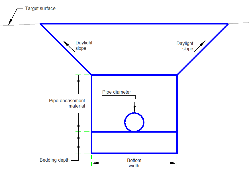

The PipeTrenchMultipleLayers subassembly has a single pipe in a trench and a layer of material encasing the pipe.
This subassembly allows volume calculation of bedding base, pipe zone, and granular backfill. The pipe is encased in a layer of material right above the bedding. The center of the pipe will have a design profile. The depth will vary in the section of granular backfill; the others will be a constant. All of the depths, widths, and diameters will change from trench to trench. The depth of the trench will vary along the alignment since it is measured from the bottom of the trench to the target surface.
By default, the attachment point is the center of the pipe.

Behavior
The elevation of the bottom of the trench is calculated as the profile grade line elevation minus half the pipe diameter plus the bedding depth. The horizontal trench bottom link is placed symmetrically about the attachment point offset at that elevation. The pipe encasement material depth is used to provide for the material around the pipe. The side slopes are extended upward to the existing surface. The horizontal bedding link is placed at the given depth above the trench bottom.
