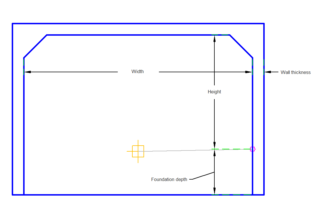

The SimpleTunnelOpenBottom subassembly is for a simple tunnel with open bottom. It uses the height, width, and material thickness that you input.
The attachment point is the bottom center of the tunnel.

| Width Double Input | Inside width of the tunnel | Numeric, positive |
10 ft 3 m |
| Tunnel Height | Inside height of the tunnel | Numeric, positive |
5 ft 1.5 m |
| Wall Thickness | Width of the walls, and roof of the tunnel | Numeric, positive |
0.5 ft .15 m |
| Shape Name | A list of codes to be assigned to the tunnel shape | Comma-separated string | Tunnel |
| Tunnel Ceiling Link | A list of codes to be assigned to the ceiling link | Comma-separated string | TunnelCeiling |
| Tunnel Inside Wall Link | A list of codes to be assigned to the inside wall link | Comma-separated string | TunnelInsideWall |
| Tunnel Top Link | A list of codes to be assigned to the top link | Comma-separated string | TunnelTop |
| Tunnel Outside Wall Link | A list of codes to be assigned to the outside wall link | Comma-separated string | TunnelOutsideWall |
| Foundation Depth | Depth of the tunnel walls below the tunnel floor | Numeric, positive |
5 ft 1.5 m |
| Tunnel Top Right Code | A list of codes to be assigned to the top right point | Comma-separated string | TunnelTopRight |
| Tunnel Top Left Code | A list of codes to be assigned to the top left point | Comma-separated string | TunnelTopLeft |

The points, links, and shapes are created using the input parameters.
Layout Mode Operation
In layout mode the subassembly displays the links comprising the tunnel.
