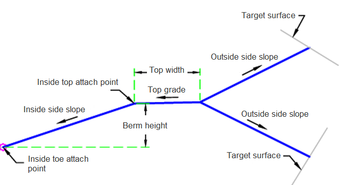

The Berm subassembly inserts links to create a berm. The berm may be created from the inside toe or inside top of the berm. The berm then daylights to a surface.
The attachment point is at the inside toe or inside top of the berm. This component can be attached to either the left or right side.
Input Parameters

Behavior
The initial inside link of the berm is created using the entered height and inside side slope. The top of the berm is created using the entered Top Width and Top Grade. A daylight link is found using the Outside Side Slope.

Point, Link, and Shape Codes
The following table lists the point, link, and shape codes for this subassembly that have codes assigned to them. Point, link, or shape codes for this subassembly that do not have codes assigned are not included in this table.
Point, Link, or Shape |
Code |
Description |
| P1 | Berm_Bottom | Bottom inside toe of the berm |
| P2 | Berm_Top_Inside, | Top inside of the berm |
| P3 | Berm_Top_Outside | Outside top of the berm |
| P4 | Daylight,Daylight_Cut | Cut slope stake point |
| P5 | Daylight,Daylight_Fill | Fill slope stake point |
| L1-L4 | Berm,Top,Datum | Berm top and datum |
| L3 | Daylight_Fill, Daylight | Daylight link for fill section |
| L3 | Daylight_Cut, Daylight | Daylight link for cut section |
Coding Diagram
