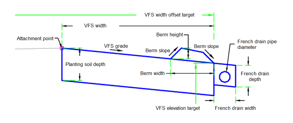

Starting at the attachment point, a finish grade surface and parallel subgrade are inserted using the given width and depth. Vertical links close the shape at either end of the vegetated filter strip. An optional berm is built at the far end of the vegetated filter strip. An optional French drain is constructed at the end of the vegetated filter strip.

In layout mode, this subassembly displays all links using the input parameters.
