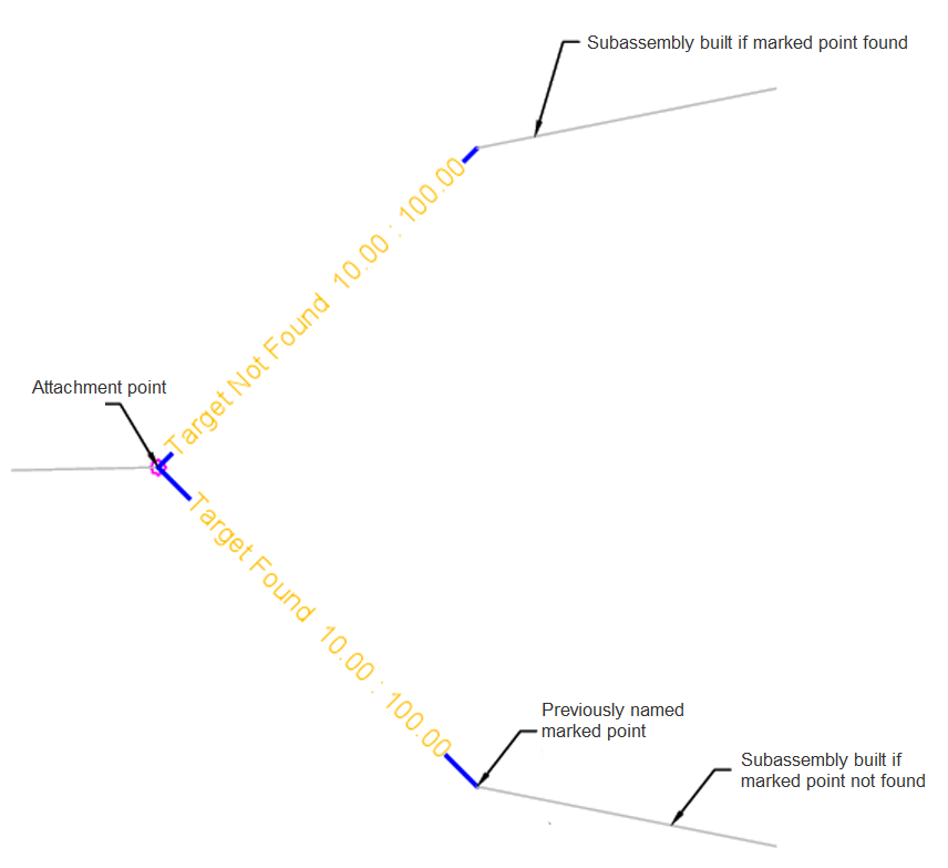

In layout mode, this subassembly draws a line using the Layout Width and Layout Grade input parameter values. This line represents the location in the assembly where the ConditionalMarkedPoint subassembly is applied.
Point, Link, and Shape Codes
Unlike most other subassemblies, the ConditionalMarkedPoint subassembly does not create any points, links, or shapes in modeling mode.
Coding Diagram
The following coding diagram shows the points and links that are created in layout mode. No point, link, or shape codes are created for this subassembly in modeling mode.
