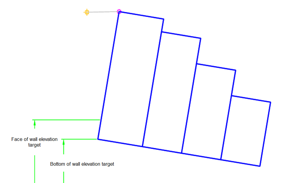

Case: Face of Wall

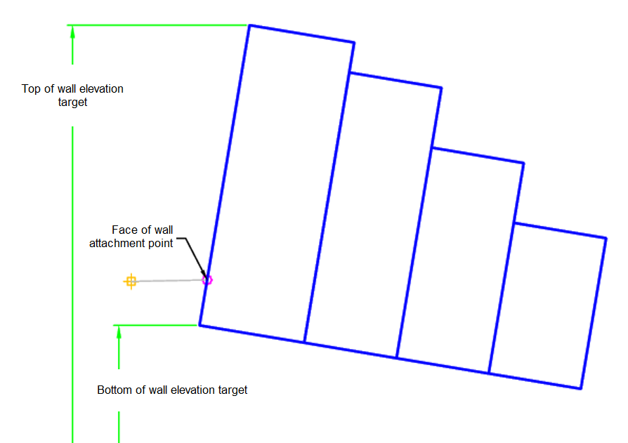

Case: Top of Wall

The attachment point is at the inside edge of the initial cut or fill slope. This component can be attached to either the left or right side.

| Attach Point | Attach point | Top of Wall / Face of Wall | Face of Wall |

| Bottom of Wall | May be used to set the bottom of wall elevation. The following object types can be used as targets for specifying the elevation: profiles, 3D polylines, feature lines, or survey figures. | Optional |
| Face of Wall | May be used to set the face of wall elevation point. The following object types can be used as targets for specifying the elevation: profiles, 3D polylines, feature lines, or survey figures. | Optional (Attachment Point = Top of Wall) |
| Top of Wall | May be used to set the top of wall elevation. The following object types can be used as targets for specifying the elevation: profiles, 3D polylines, feature lines, or survey figures. | Optional (Attachment Point = Face of Wall) |
