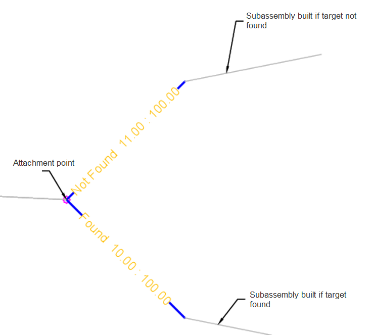

Coding Diagram
The following coding diagram shows the points and links that are created in layout mode. No point, link, or shape codes are created for this subassembly in modeling mode.
