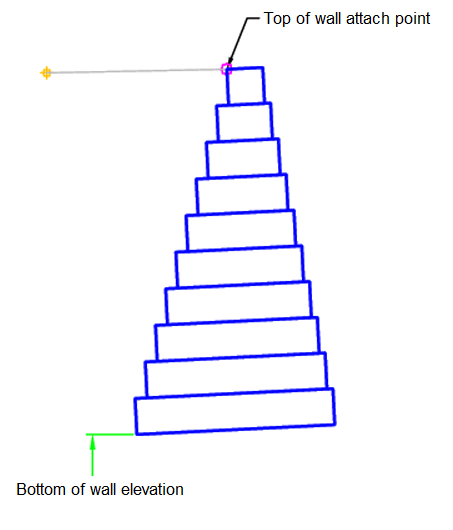

Case: Attachment at Top of Wall

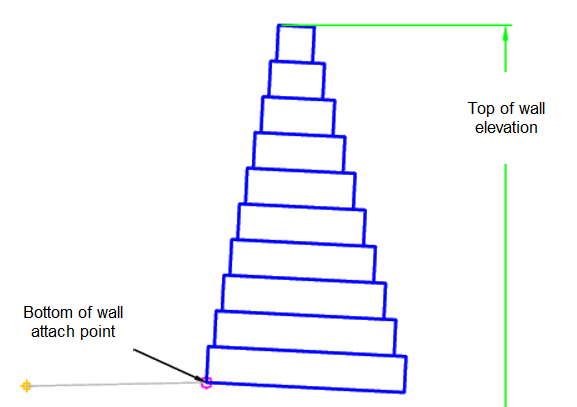

Case: Attachment at Bottom of Wall

The attachment point is at the inside edge of the initial cut or fill slope. This component can be attached to either the left or right side.

| Attachment Place | Attachment place on wall | TopOfWall / BottomOfWall | Bottom Of Wall |

| Top of Wall Elevation | May be used to set the top of wall elevation when the attachment point is set to bottom of wall. The following object types can be used as targets for specifying the elevation: profiles, 3D polylines, feature lines, or survey figures. | Required when attachment point is Bottom of Wall |
| Bottom of Wall Elevation | May be used to set the bottom of wall elevation when the attachment point is set to top of wall. The following object types can be used as targets for specifying the width: alignments, polylines, feature lines, or survey figures. | Required when attachment point is Top of Wall |
