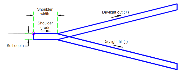

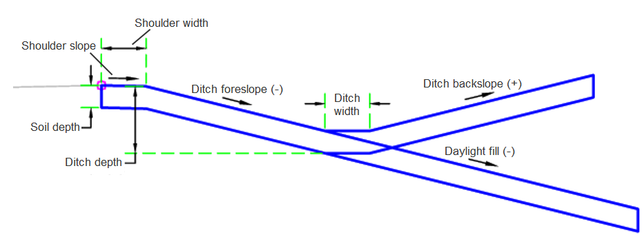

The ClarkCountyBasicDaylight subassembly inserts links to create cut or fill catch slopes with a shoulder. You can define a ditch in cut situations.
You should verify that the dimensions used match your interpretation of the standard plan.
Case 1: With Ditch
Case 2: Without Ditch
The attachment point is at the inside edge of the initial cut or fill slope. This component can be attached to either the left or right side.

Ditch Depth Ditch depth from attach point Numeric
1 ft
0.3 m
Ditch ForeSlope (-) Ditch Fore Slope Numeric -4 ( : 1)
Ditch BackSlope (+) Dich Back Slope Numeric, positive 4 ( :1 )
