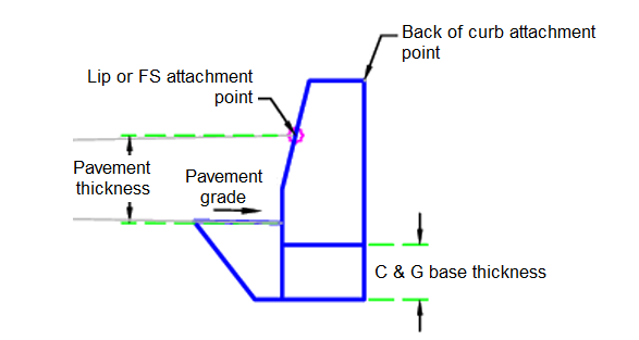

The attachment point is at the Lip (or FS) and the Back of Curb. This component can be attached to either the left or right side.

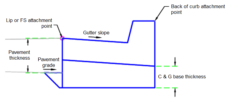

Side Specifies which side to place the subassembly Left / Right Right
Curb Type Type of curb or curb and gutter Type A Curb 6" and 18" Gutter / Type C Curb 6" Type A Curb 6" and 18" Gutter
Attachment Point Attachment point for the curb or curb and gutter Lip or FS / Back of Curb Lip or FS

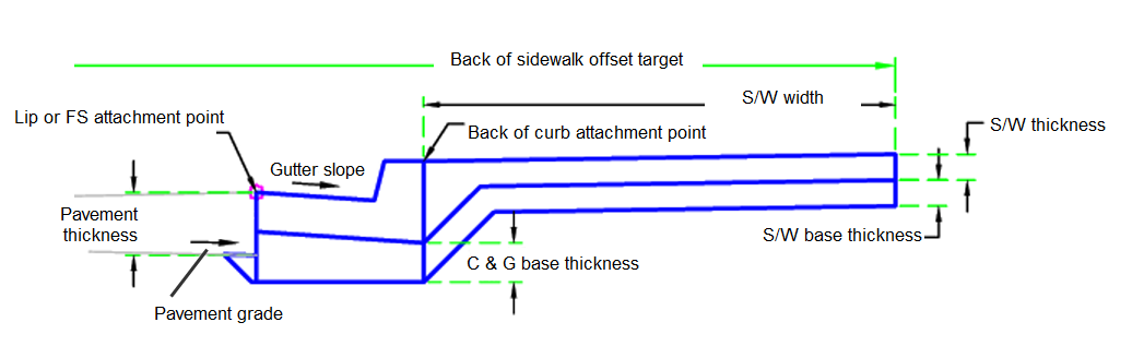

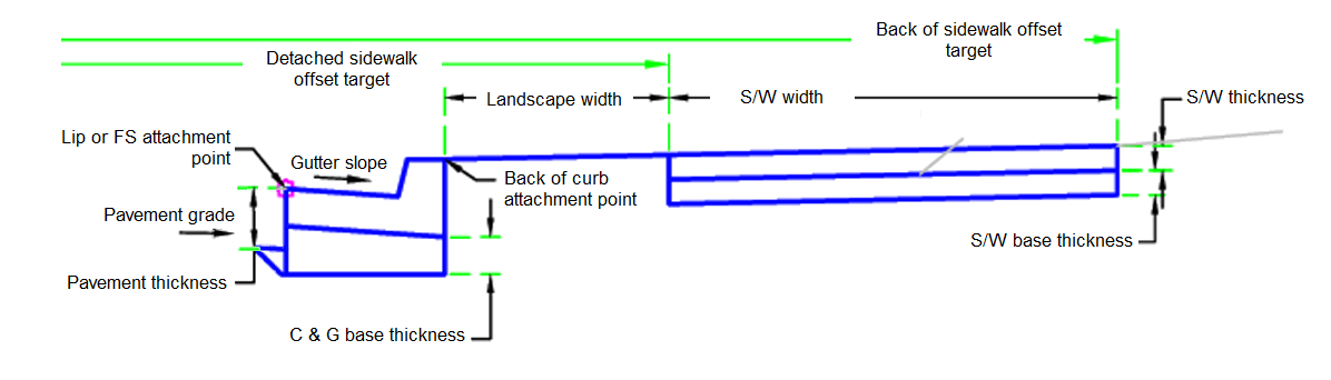

Sidewalk Type What type of sidewalk should be used (or None) Detached / Integral / None None
Gutter Slope Gutter slope, varies at curb ramps Numeric 6.90%
C & G Base Thickness The thickness of base below the curb and gutter Numeric, positive
0.5 ft
0.15 m

S/W Width The width of the sidewalk Numeric, positive
6 ft
2 m
Landscape Width The width of the landscape when using a detached sidewalk Numeric, positive
3 ft
1 m

Detached Sidewalk Offset May be used to override the fixed sidewalk width and tie the inside edge of sidewalk to an offset alignment. The following object types can be used as targets for specifying the width: alignments, polylines, feature lines, or survey figures. Optional
Back of Sidewalk Offset May be used to override the fixed sidewalk width and tie the outside edge of sidewalk to an offset alignment. The following object types can be used as targets for specifying the width: alignments, polylines, feature lines, or survey figures. Optional

If the sidewalk type is not set to None, then the appropriate sidewalk and base is built. If the sidewalk is Detached and the Detached Sidewalk Offset is set, then the inside sidewalk edge is adjusted. If the Back of Sidewalk Offset is set, then the widths of all sidewalk types are adjusted.

P1 Flange Flange of gutter
P2 FL Flowline of gutter
P3 Front Front of curb
P4 Back, Sidewalk_In Back of curb, inside edge of sidewalk
P11 Sidewalk_Out Outside edge of sidewalk
P16 Sidewalk_In Inside edge of sidewalk
L1-L3 Top, Curb Top of curb
L5, L6 Bottom Bottom of curb
L9, L11, L12, L15 Subgrade, Datum
S1 CurbAndGutter Curb and gutter concrete area
S2, S3 Base
S4 Sidewalk Sidewalk concrete area
S5 Sidewalk_Base
Coding Diagram
Curb and Gutter:
Curb:
Detached Sidewalk:
Integral Sidewalk:
