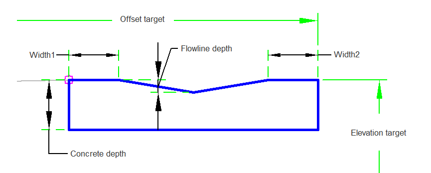

The ValleyGutterSimple subassembly is a concrete valley gutter with user defined widths, concrete depths, and flow line depth. The width can be modified and the flowline stays at the center.
The attachment point is at the inside edge of the valley gutter.
Input Parameters

This subassembly will insert a simple valley gutter. The location of the width of the subassembly can be specified with a fixed width, or with an optional alignment. The valley gutter can be specified with a fixed depth, or a profile can be assigned to control the depth.
Layout Mode Operation
In layout mode the subassembly displays the links comprising the valley gutter with the user input values.

| P1 | Top, Hinge | |
| P2 | Datum | |
| P3 | Datum, Concrete | |
| P4 - P6 | Top | |
| P7 | Flowline, Top | |
| L1, L3 | Concrete | |
| L2 | Datum, Concrete | |
| L4 - L7 | Top | |
| S1 | ValleyGutter |
